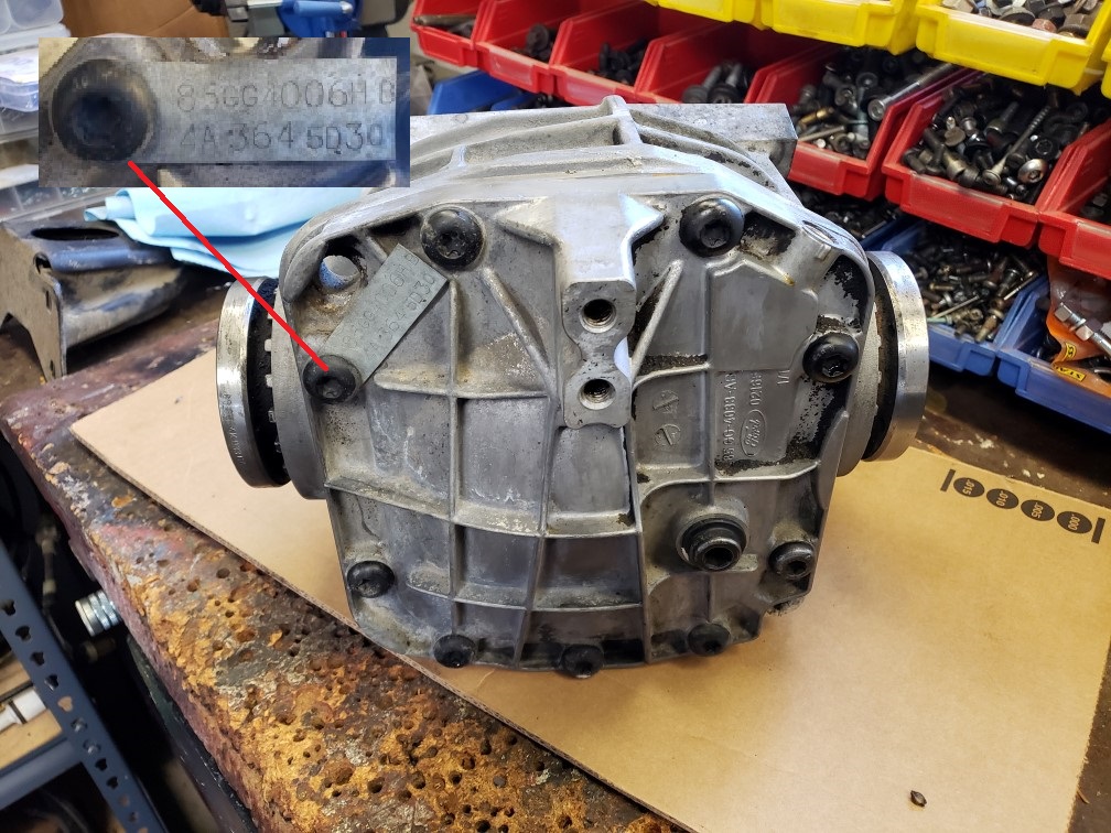

Last week I dropped the driveshaft off to be lengthened and get new u-joints and the PTI yoke installed. Today I got the spare 3.64 diff out of the back of the garage....

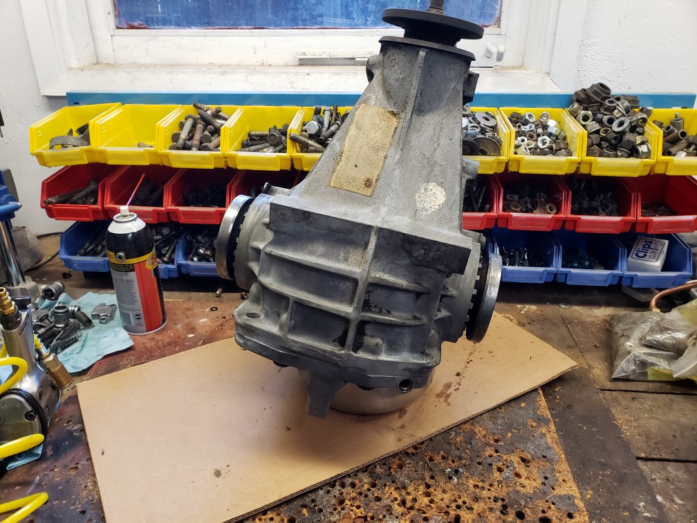

It was gross from being put away dirty 15 years ago, so I spent some time cleaning it up a little.
Then I drained the fluid and called it a day. :D

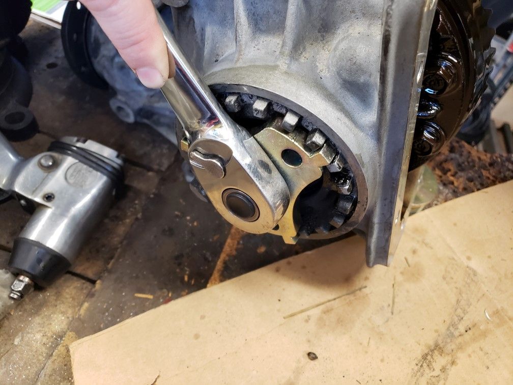

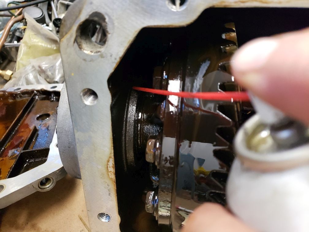

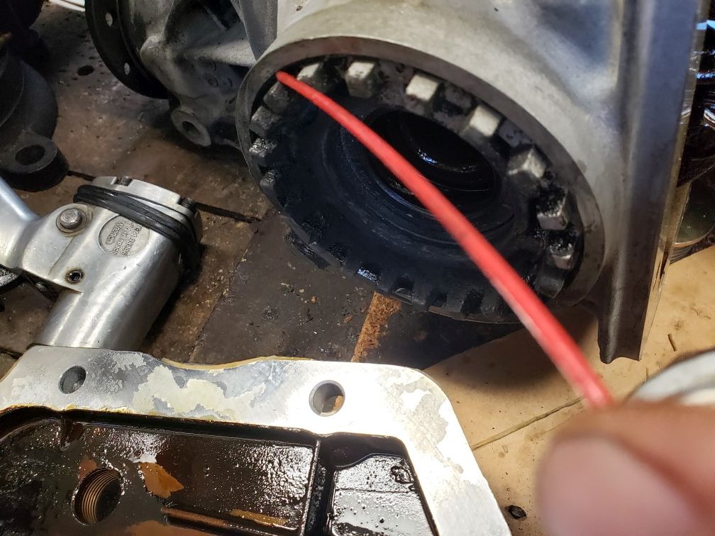

Pulled the rear cover off and removed the c-clips holding the axle stubs in. I couldn't get good purchase on the clips using a pick or anything, so I used a pair of screwdrivers (as advised by mc2) to push them off. That worked readily. I hosed down the bearing carriers with penetrating oil inside & out to ease removing them...
The tool mc2 supplies for $20 is well worth it IMO because it just works. In their instructions they recommend standing on the diff and using a breaker bar, but I was able to remove them easily using just a 1/2" drive ratchet.

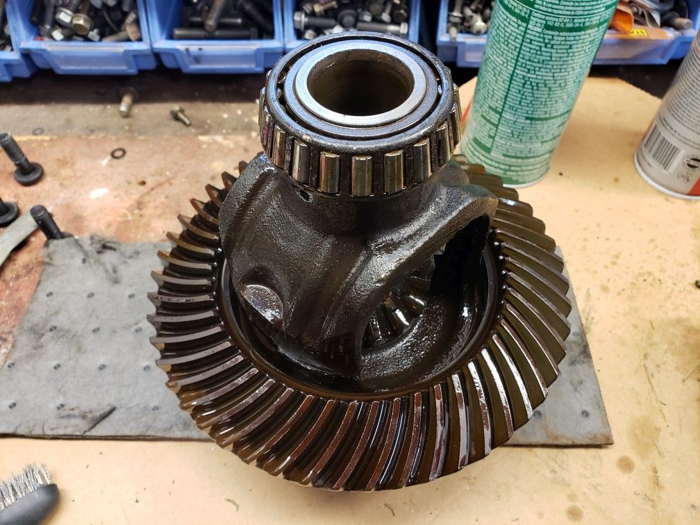

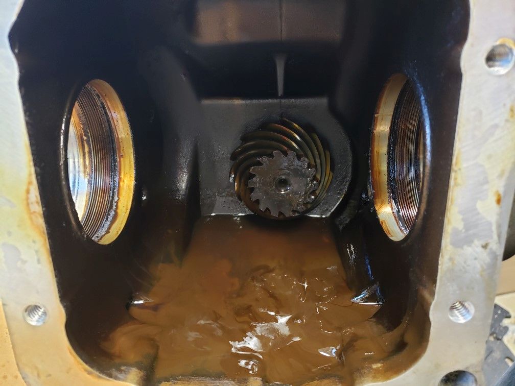

Once the adjusters are out, the diff itself comes out easily.

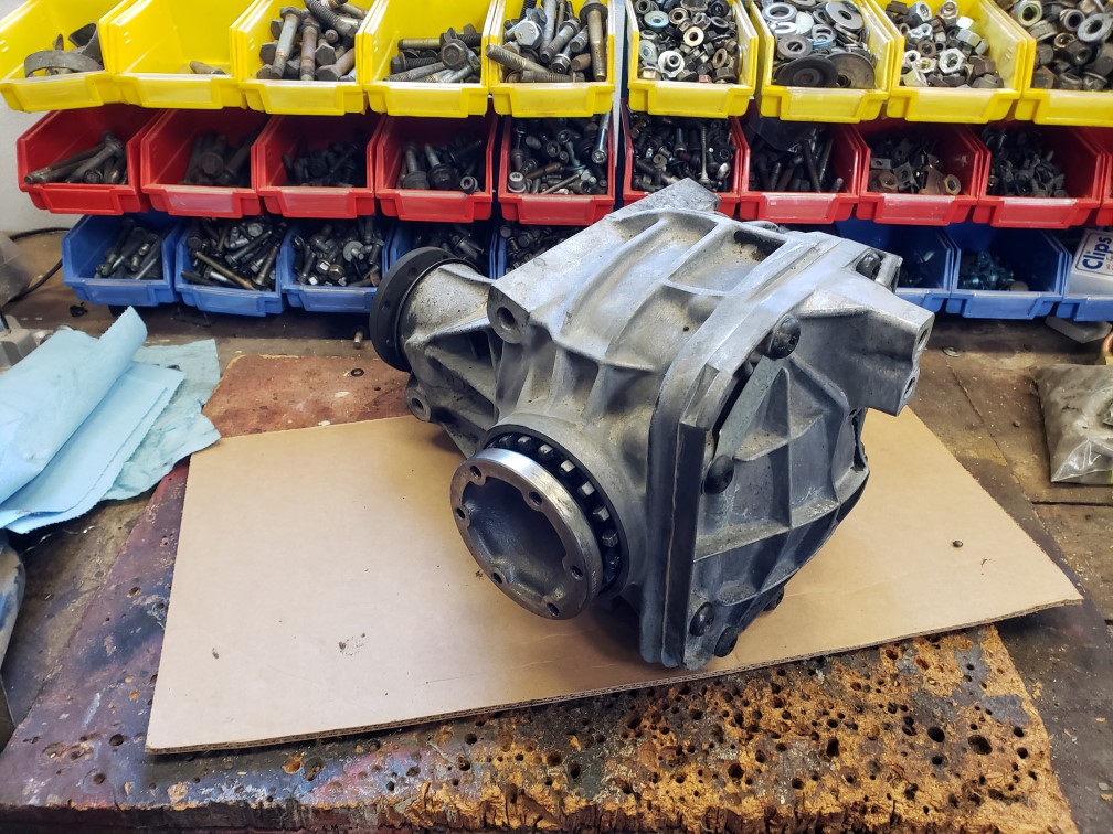

Leaving a sad, empty, gooey housing...
This particular diff probably has very low mileage. It came from a car that was wrecked in the early '90s and sat in a barn for 10 years before I bought it and took it apart. The diff has been in my garage for about 15 years, no doubt collecting moisture, etc.
I think the next part is giving mc2 a bunch of money and then shipping them some pieces. :D
